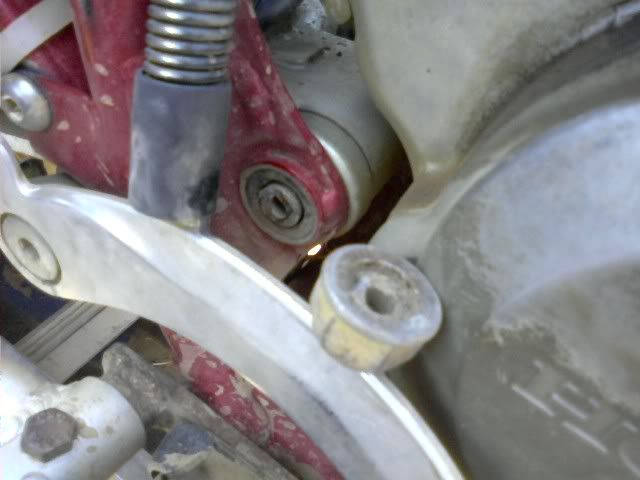

I broke the swing arm bolt on mine this week.
