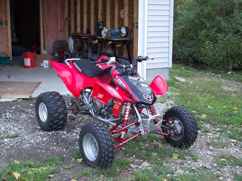

well i finally got em and they are on. they look really good. thanks dave
i should be getting my linkage friday

Looks good some new front wheels and some revalves and your set.
Looks real good man, that quad looks clean. Any plans for axle and different front wheels?
ya when i get the money
now thats tight. job well done. amazing what some +2 arms do to the look of a bike not to mention the ride stability. youll need to flip your front wheels though. some rear 18" tires and youre set. congrats.
now thats tight. job well done. amazing what some +2 arms do to the look of a bike not to mention the ride stability. youll need to flip your front wheels though. some rear 18" tires and youre set. congrats.[/b]
they arent flipped. thats just the offset of them. if i flipped them the valve stem would be on the inside of the tire.
what i meant is FLIP them. since you have the +2 arms you problaby dont need to run that offset. but if you like them or want to u can still leave them as is. just my .02

what would i do with the valve stem? it would hit the brake
flip it inside out, then drill a hole on the other side of the wheel for a new valve stem, thats what ppl do when they flip stockers

thats exactly what we did on my bro's bike

how do you fill the old hole?

that they are. only thing weird is when me and my friend got em on one side looked wider than the other. so we measued it but they are the same. must be an optical allusion.

buy 2 new valve stems for the new holes you drill, take the ones that are in the wheels now and turn them inside out, like make the part that you put air in now go up inside the tire, that should make it short enough to clear your brakes.
Put valve stem in up-side-down.
exactly, put the valve stem on the inside of the rim inside out and the stem on the outside of the rim (the new hole) right side out so you can fill the tire with air.
I used the trick on my EX back in the day.

remove the stem and reinstall it inside out.
i might have to try that. but i might just buy new tires to go on the stock rims. how hard is it to remove and mount tires? ive never done it before
