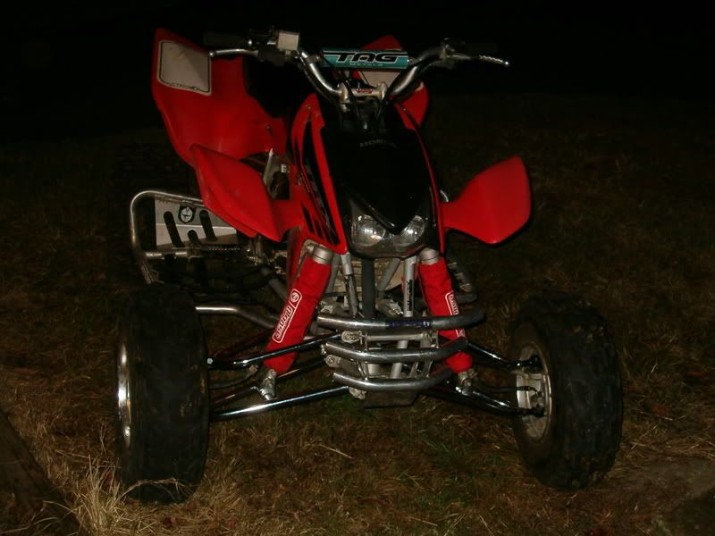

Haven't done much to it since I picked it up for $3k. It came with a full Dasa exhaust, K&N filter, jetted, Pro-armor nerfs, AC grab bar, Armadillo front bumper, and TAG XS bars. Here's some pics.
I have to replace the front lower motor mount bolt, so it's ordered. I also picked up some new Scott grips to get rid of the ugly, worn, orange TAG grips. I'm also talking to a guy about some stock width Hermann a-arms. I'm not so sure about them though since I'll have to replace the bushings in them. Will the bushings from my stockers fit them? Anyway here's the list I plan on doing....
in the next month or so - Hotcams Stg2 cam, matte black pc'd wheels, new Holeshot tires, stock width or +2" a-arms
over winter - Hot Rods +3mm stroker crank, JE 11.5:1 piston, matte black pc'd frame, candy red pc'd hubs/a-arms
next spring/summer - GT thunder shock conversions, Quadfast graphic kit

Went ahead and bought some +2" Burgard arms today. Figured for $200 it wasn't worth my time and materials to try to build some. The shop didn't have any ball joints and AutoZone/Napa/Advanced Auto didn't have any of the Volkswagen ones, so I couldn't get them installed. Been working on the jetting, but can't get it right.
Cut my box lid and put a 175 jet in today. It's a bit lean, but not stalling anymore. I'll adjust the fuel screw some and maybe have to put in the 180 jet.
I picked up the ball joints and one of them is the wrong one and none came with nuts, so I'll pick some nuts up at work and have to order the right one.
Finally another update. Finally got the right balljoint in today and got them all put on. I also relocated the ignition and oil temp light to under the hood. I'll have to get a better pic of that though. Sorry for the night pics.
top a-arms look like they are on the wrong sides
