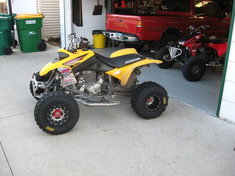

I ran the Sparks x6 exhaust full system, Sparks key, Sparks cam, 39FCR and an IMS440. That thing was a torque monster, I miss it sometimes.
The easiest mods for an EX are Exhaust, filter, cam, revbox. WORLD of difference right there.
