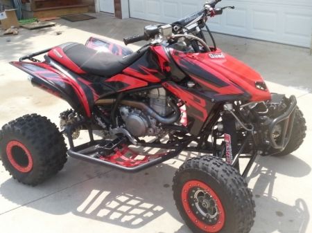

Hello everyone I've just joined and already this forum has been very helpful. I just bought a '05 450R a few days ago at a steal of a price. I have two other Honda utility ATV's and have loved them so I jumped on this when I seen it. However, I'm having some issues with it...
It is very hard to kick start. When I say that I mean 30-40 tries and this thing just won't fire up. When it finally does, it runs great. Once running and warm there are no problems throughout the RPM range. No bogging, stalling, or anything. It's just getting the darn thing started.
Let me provide some more info. The quad is all stock internally as far as I know. Even the air filter and box are unmodded. Where I live is about mid forties temperatures right now, but the quad is kept in a heated garage. Elevation is 549 feet. When trying to start I read to kick it on the compression cycle, which I've tried. I also read to pump the throttle once or twice before kicking, which I've tried. I've also read to choke it, kick once, then un-choke and kick, which I've tried. All to no avail.
This is the first kick start I've owned and I'm not very knowledgeable around a carb. I've already downloaded the free service manual off here and read the sticky about carb jetting to try to gain a little more understanding (both are very helpful thanks!) I guess what I'm looking for is some tips or pointers to lead me in the right direction on what is going on. It's very frustrating reading how everyone else's fires in 1-2 kicks! haha
Any help is greatly appreciated and thanks!

PS welcome and post some pics off your R
thanks for the input guys. I was hoping I could avoid tearing it down too much, but that doesn't look like that'll be the case.
