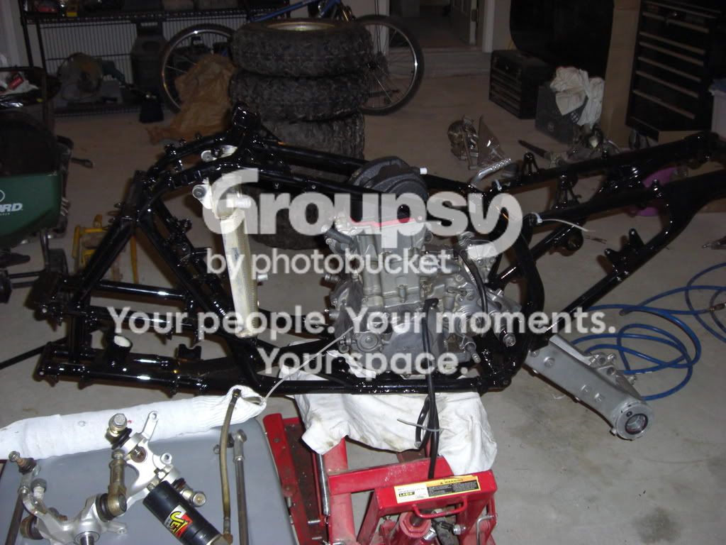

rebuilt the bearing carrier and dropped the engine in the frame after cleaning it up for a while

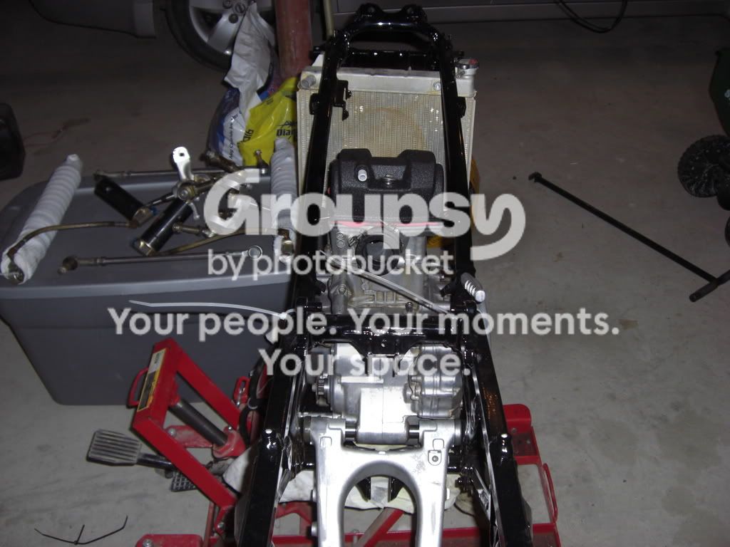

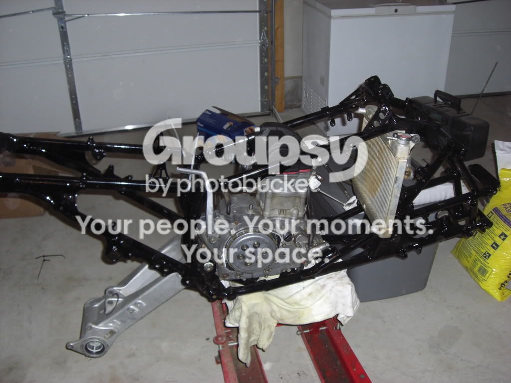

Next time we worked on it 3/7/09 we got the rest of the engine mounts on and mounted. The stock rear shock on! I know stock rear shock but I didn't think I would be able to get a rear shocks so its on there!. got the clutch cover and valve cover on with their new gaskets and hardware and I replace the right and left side cases covers with the new S.S. hardware! also got the radiator in and the oil cooler!
OCO5450R
on 3/13/09 I received my All balls steering stem bearing kit, Traxx performance sprocket guard,complete stainless bolt kit, and GT Thunder rotor guard. I also received my parts order from Rocky Mountain I got my front and rear steel sprockets and a x-ring gold 520 chain along with a smaller 13 tooth sprocket for tighter areas along with a billet gas cap with billet breather just cuz lol.
On 3/15/09 we got the carb on, steering stem bearing in,rear master cylinder on and found out I need a rubber dust cap on the brake pedal because there is side to side slop!, got the coil on and the rectifier on. I also picked up a plus 2 anti-vibe stem from burguard cycle along with my stainless brake lines.I had to get 04-05 hubs to work with the 04-05 spindles that came with the ARS-FX setup since the front end on my 05 was from an 06 so they don't work!
