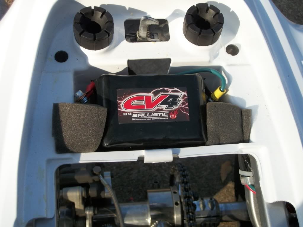

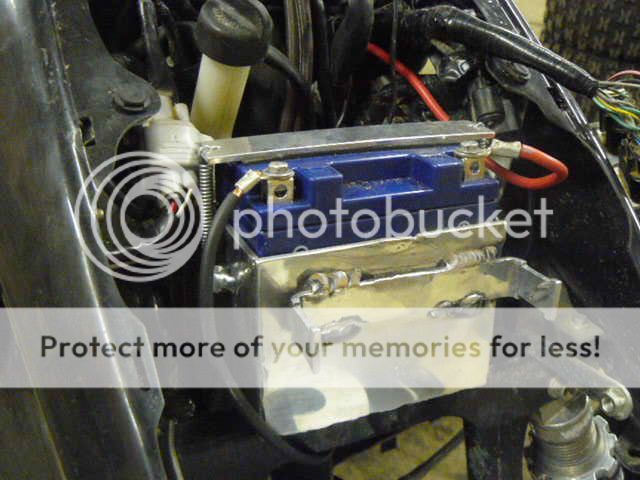

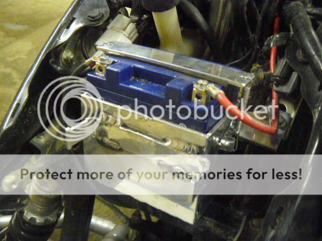

I have a 24volt start system. I currently have the ORP style box, where it's mounts upfront under the hood. And i use a Tru-Gel battery on the front battery, and still have the OEM in the original spot. Next time, i will use 2 of the 4 cell Ballistic Battery's. They will fit in the same spot as the stock battery. and each battery only weighs 3/4 of a pound. They are Lithium style battery's, each 4 cell is 135 CCA also. so you go to a 24 volt system and lose weight. We have done this with the Yamaha already, and it worked Awesome!
And you only have a make a short wire to wire the battery's correctly, instead of one to chase the battery all the way to the front and back to the starter.
Keep in mind the Second battery does NOT charge, so after using it you will need to charge it, I have a battery tender lead connected to my battery all the time, and after each ride i just plug it up and it's good to go next time.

Here is my Honda, and the Yamaha we did, The way we did the yamaha will work on a honda also, those two battery's will fit in the stock Battery Holder.
